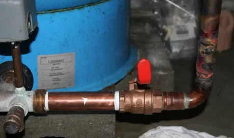

Looks like I've got some fun to look forward to this weekend... would appreciate any advice on this. I'm getting a steady drip off the straight threaded pipe section between the well tank and the shut off valve on the right. This all just started since last night - fortunately I happened to be in the basement tonight and last night to see it or this could have gotten much uglier.
The worst part is that it is not leaking at the threads - the pipe itself is splitting open on the bottom. I checked this more than once to be sure by drying the pipe. It looks like the plumber used a pipe wrench on the section between the well tank and shutoff valve, gouging the bottom of the pipe. Since it's often got condensate on it, I'm guessing that in 5 years it's completely corroded through the teeth gouges and is now leaking. I have no way to stop it other than shut off the well and drain the tank. I do have a shutoff valve to avoid having to drain the house pipes at least.
Despite the threaded ends on the pipe, it's not clear to me that I can remove this without having to cut the copper pipe above the elbow to allow things to rotate and take out the bad pipe. Am I missing anything to make this job easier?
I could just cut the bad pipe out and then remove it, but then I'm not sure how I would get a replacement inserted. If one of the sides had a reversed thread, I could see how this could have been made easier but doesn't look like it.

I'm no plumber but I'd unsolder the threaded connection to the right of the main just before the elbow, then unscrew everything to the left. Once the offending pipe were replaced, then I'd just resolder the joint back in place.
-Kevin
Looks like that valve might have a union fitting on the right side. If so break that loose and remove the valve and the pipe, replace the pipe then retighten the union.
I had a similar situation about 8 months ago. I cut the pipe at the leak and soldered a coupler on it. It was fast and effective.
...what Kevin said.
Sweat (off) the 3/4 NPT to 3/4 copper piece to the right of the valve.
Unscrew the 3/4 pipe to the left of the valve, and replace with a galvanized steel pipe.
Sweat the NPT fitting back together.
If you not comfortable with soldering, then cut the copper above the 90 degree street connection (to the right of the valve), spin off the valve and bad section of pipe, reassemble, then use a brass 3/4 union compression fitting to put the copper back together. Make sure you leave at least an inch above the elbow to make room for the union.

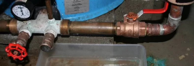

The attached picture shows the disaster I had trying to solder the final coupling to reconnect the water supply. Don't laugh - I know it's a mess. I think I'm not getting it hot enough, which is frustrating given that this is the first time I'm using the MAPP gas torch. I never saw the solder flow - on this joint or the existing one right below it where the 1" pipe goes into the elbow. I suspect that water in the brass nipple is just a huge heat sink and preventing me from getting up to temperature. Eric - I had an outside faucet open which is not too far beyond this point to help vent. I also went at the surfaces of the pipe and coupling w/wire wheel on the dremmel tool to get off any corrosion following by a light sanding, and thought I had it all nicely covered w/flux. Any other ideas on what is going wrong here?
To go at this a bit differently, I'm thinking I could cut the pipe above the messy coupling and take out the elbow/NPT transition and assemble a replacement on the floor with the right length of 1" copper pipe. Then thread that assembly in, and do the final coupling with a 1" shark bite slip coupling rather than risking screwing up another solder connection at the very end.

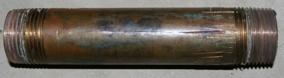

By the way, here are a couple pictures of what started this... the original brass pipe was splitting wide open after just 5 years. The bright teeth marks from a pipe wrench are from me taking it off as it really didn't matter at this point, but there are some from the builder's install. Not clear if they caused it to start splitting or not.

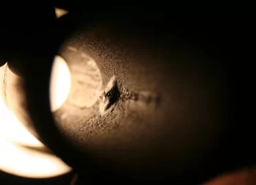

Also got a picture of the inside - there is a lump and some other crud along the crack on the inside of the nipple.
I couldn't help but notice the Made In China stamp on the pipe either :-)
Any ideas on what caused this failure? I have a much easier to access similar brass nipple on the other side that connects up w/the poly line to the well, but I'm not sure I should even bother with it - as I understand, that is not necessarily under the same house water pressure.

You still have some water in that pipe and since you heated it ....ALOT.....All the flux burned away...... Can you open the valve there and then the boiler drain valve and let the steam out?
Any chance the pipe ever froze weakening the pipe?
