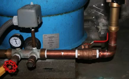

GVA is right--you've got water in the piping, making it impossible to get the fitting hot enough to solder correctly. Is there a way to drain the water off above/below the fitting? If you have a leaky valve, then you might have to turn the water off at the main shutoff and wait for it to drain out. A Sharkbite is probably not a bad solution if you can't get it dry. And if it's domestic water, you can always try the old lump of bread trick.
But in any event, you have to take the fitting off and clean/flux everything down again before you try to resolder. If any of your solder stuck, you might need to cut it out. That's usually the easiest approach.

Round 2 was a success! Sure enough, apparently a bunch more water had gotten into the bottom of that elbow after I put the coupling on that I was attempting to solder.
I assembled the NPT fitting and elbow to a straight pipe section still short enough to rotate around to thread it in. Then I used a shark-bite slip coupling to close it up - worked great!

NY Soapstone said:
Well, round 1 didn't go so well today... got the new 6" brass nipple installed and pressurized it up to the valve to check that it was leak tight before going any further - no problems there. I'll have to post a pic of the old one - it was cracking right down the middle.
The attached picture shows the disaster I had trying to solder the final coupling to reconnect the water supply. Don't laugh - I know it's a mess. I think I'm not getting it hot enough, which is frustrating given that this is the first time I'm using the MAPP gas torch. I never saw the solder flow - on this joint or the existing one right below it where the 1" pipe goes into the elbow. I suspect that water in the brass nipple is just a huge heat sink and preventing me from getting up to temperature. Eric - I had an outside faucet open which is not too far beyond this point to help vent. I also went at the surfaces of the pipe and coupling w/wire wheel on the dremmel tool to get off any corrosion following by a light sanding, and thought I had it all nicely covered w/flux. Any other ideas on what is going wrong here?
