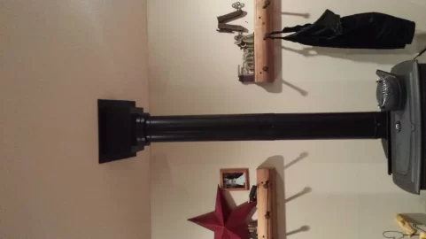

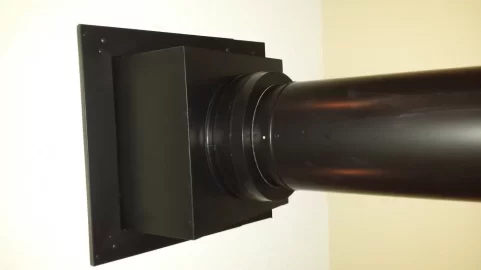

We left Sunday morning for a two day family trip. Came home tonight (monday) and was excited to start the fire back up and immediately noticed a large water mark rusty circle on top of the stove. Turns out the the thimble around the stovepipe had water dripping from it. Sorry if terminology is wrong. Never had this happen before. Is it from the warm house air meeting cold outside air there? I'm assuming the space in that box is uninsulated. Is there a way to insulate it? We've never had this happen before but we do burn almost 24/7 so maybe this is the first time it's had a chance to happen. Just doesn't seem right. What if we decided to only burn casually? It would condense all the time then. I'm hoping you guys have ideas or suggestions before I call the installer. The black box around the stove pipe that I called the thimble was ice cold to the touch before I started a fire [Hearth.com] Help!! we came home to a serious problem![Hearth.com] Help!! we came home to a serious problem!

We left Sunday morning for a two day family trip. Came home tonight (monday) and was excited to start the fire back up and immediately noticed a large water mark rusty circle on top of the stove. Turns out the the thimble around the stovepipe had water dripping from it. Sorry if terminology is wrong. Never had this happen before. Is it from the warm house air meeting cold outside air there? I'm assuming the space in that box is uninsulated. Is there a way to insulate it? We've never had this happen before but we do burn almost 24/7 so maybe this is the first time it's had a chance to happen. Just doesn't seem right. What if we decided to only burn casually? It would condense all the time then. I'm hoping you guys have ideas or suggestions before I call the installer. The black box around the stove pipe that I called the thimble was ice cold to the touch before I started a fireView attachment 122238View attachment 122239

First, sorry you are having trouble. Second. you may not insulate inside that ceiling support.
So let's figure this out. Can you access the chimney from inside an attic space? If yes then an inspection with a good light is in order. If not then let's use process of elimination. If condensation is expected, where is the water vapor coming from? i.e. a sub zero temp system will typically have low humidity accompanying it. Check the weather history, what has the humidity been? If under %50 I would not suspect condensation from outside air. So is there a moisture source from inside your home, i.e a vent-less gas heater? Or a high efficiency gas furnace that may vented improperly or very close to the chimney? If no moisture source can be surmised I would then suspect a leak that will need to be inspected and handled by a roofer.
In any case your chimney looks like a DuraTech system. Ask your installer if there is an attic insulation shield in place. This part allows insulation to encompass the shield while insuring the required 2" air space clearance around the pipe. This is the best insulation available for this system.
