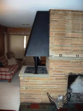

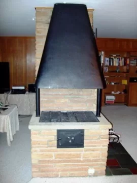

Also I have two options of where to place the stove. They are both in the center of the house.

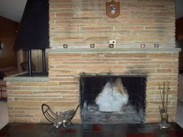

1st is in the fire place and go directly up into the clay pipe 10"x 12" chimney? There is 18" of hearth in front of the where the stove would go.
2nd is I have an indoor charcoal grill and I could remove the steel hood and pipe a 90 into that clay pipe chimney. It would be 30" of the ground for easy loading.
Only problem in using the chimney with the grill is that I believe my gas fire place(1st back up) in the basement may run through it. I assume this is a big no no?
The water heater and furnace have a separate chimney so thats not a problem.
So is a 316 stainless liner/flex pipe the only way to go?
Or should I use the masonry chimney?

Put it in the fireplace. Sitting up on that barbecue brickwork would put the stove too close to the ceiling for clearances to combustible materials. And were the brick work to not be able to hold up the stove, 500 pounds of hot steel and burning wood tumbling out into the room would be a real Come To J moment. Eyeballing that fireplace it looks to be around 35 inches high at the lintel so the 30 would fit.
When moving it when you take out the bricks and take off the door you peel a hundred or so pounds off of it but most dollies aren't big enough for its footprint. The ideal mover for it is a pallet jack. Believe me.

The fireplace is 30" high x 36 wide x 20" deep so 5" will be sticking out on the hearth.
What about the chimney?

Put a liner in that chimney. It is the only way to go. Safer, easier to clean and does wonders for the draft through the stove.

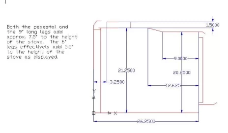

I wonder why the website says 27 3/4" high?
Does the stove than measure 30 3/4" high?
I will look for a pallet jack. any idea how high you can jack it up off the floor?

The 27 3/4" is the height of the stove with six inch legs or the pedestal. It comes with nine inch legs these days. 29" to the top of the flue collar with the ped or the six inch legs.
