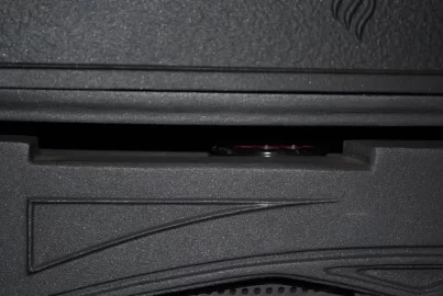

On the left hand side where the blower air comes out you can see the fire box. I positioned a magnetic thermometer in there with 600 degrees facing me. You can then shine a flash light into the vent hole to see what you're burning at. Lucky for you I have my stove out today to put in a block off plate :)

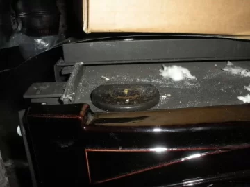

Here's a pic of what it should look like sitting in the blower air chamber. In this picture I had the thermometer pins towards the front so I could see it easier. You should have no problem getting this stove to 500-600 degrees on a full load.

Stejus< thanks for the reply. I tried this when Gil posted his response. I am burning right now with my thermometer in that exact location, I am sitting at right around 625 degrees as we speak!! Thanks for this idea!

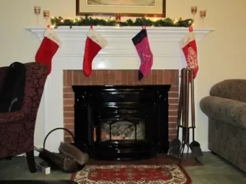

Hey Phil, This is my first stove. I had done some shopping around with Vermont Castings being my other choice. I really can say I have no complaints with my Hampton. It is more of an issue being a first time stove user than the stove!!!! I have gotten so many compliments on this stove, I got the timberline brown color. I will attach a picture of the stove!!!
