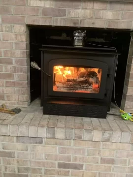

I did not install the surround surround on my insert. I need to cut a piece of single wall 8” pipe to cover up the adapter and insulated liner. Some units it may look better without the surround than others.
Thank you for the photo. That is helpful to see. The models I am considering look somewhat like yours. I agree, some models will look better than others. The flushmount options at the dealer I don't think would work as well in this application.

By not installing the surround you have more choice in how far forward or back the unit sits. Mine is as far back as I could go and I removed the top firebrick and reset it 1” further back. This way I get my 16” clearance out front with the existing hearth
