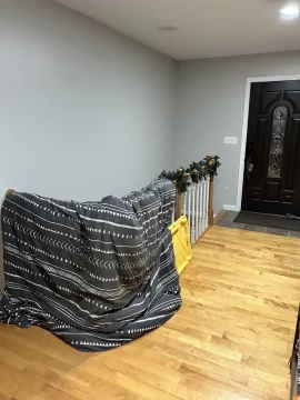

I wanted to thank everyone in this thread, specially EncoreInMass. With everyone’s helps I’ve gotten the air moving around and heating the house! Haven’t used oil of heat pumps even when it’s been down in the low teens at night! I ended up with a fan blowing into the stove room, a fan at the angle of the stairs blowing down and a fan down the bedroom hallway blowing toward the stairs. I also put a thick blanket over the stair railing and that seemed to have really helped, I think it allows the hot air to raise without mixing with the cold air. Included a photo just to clear up the staircase layout.
Thank you again for all the help, it has really helped!
