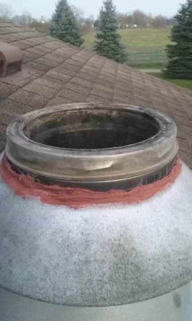

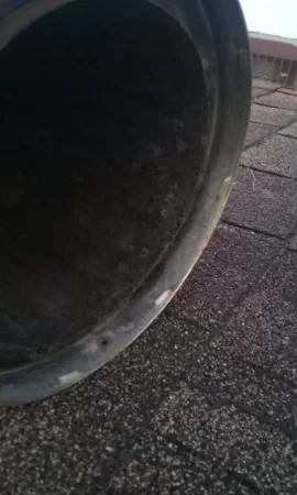

Recent purchase of an old farmhouse with existing 8" class a but is about 3 foot too short so I need to identify to match up flange styles.
Hopefully the pictures work

Not saying it is, but looks similar to Simpson DuraVent/DuraPlus
I'm not a chimney expert and pro's on here would know probably for sure but it looks like DuraPlus/DuraVent to me too. My buddy just bought a stove with DuraVent pipe and we installed it this past Saturday, looked just like that. Sometimes you can make out manufacturer on the cap if there was one
These pics aren't conclusive. Do you have a picture of the cap?
Will get pictures in the daylight. I've been looking at menards online and seems to look the same as their supervent. That is if the pictures online represent what the supervent actually is, have not yet brought the 1' section i have to store to verify
