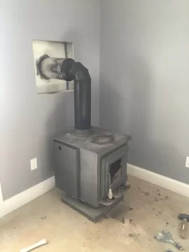

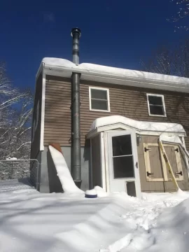

I bought my house from my grandparents and they have had this chimney setup for 30-40 years. I have a walkout basement and the pipe goes through the foundation at about 4' off the floor and then up well past the roof. It is 7" pipe that I have adapted to 6" inside. The brand pipe is Amerivent I think.
On cold days it is very difficult to get a draft. If you take the pipe off and place your hand there you would think there is a fan blowing down. I had the stove hooked up to the masonry chimney for awhile and just moved it back yesterday due to finishing the basement and wanting the stove on that side.
Last night I had the stove going great and about 10pm I dampened it down nice and went to bed, this morning there were still hot coals in the bottom, the stove was warm, stove pipe ice cold, and I could feel the reverse draft and I had CO in the house.
The chimney is clean, the top of the chimney is 2' higher than anything within 10'. Back in the day my father even said they raised it even more with no luck. I was told this was a "cold plug" and it just because of the exterior chimney, but I read here other people with these chimneys without issues. I was thinking on buying the "Tjernlund AD-1 Auto Draft Stove Blower" but hate to spend $150 to still have a problem.
The stove is an Englander with the pipe coming from the top, the old stove was a rear discharge with the same issues.

is the chimney insulated or is it air cooled pipe?

I believe it is air cooled triple wall. I looked up Ameri-Vents site and they have both, but my father said he is pretty sure it is air cooled. The chimney is at least 40 years old but looks identical to the current versions online.
bholler gets the prize again. That picture tells a lot. He see's one and grabs the screw gun !
The two types today will be "pack" which is 1 inch thick densely packed double wall (6 inch ID will be 8 inch OD) or triple wall which has a thin insulation wrap around the inner liner and appear the same size as your outer pipe.
Yeah if it is air cooled that is probably the problem. They cool much much quicker than insulated chimneys. The air cooling works great for protecting the house but does not work well performance wise.

I really strongly feel that both the fan and the draft collar are just bandaids that will possibly just cover up the real problem. I would say to fix it the chimney needs replaced.

Yes but the current chimney is air cooled not insulated. They are totally different with an air cooled chimney performance wise it is pretty much the same as single wall pipe out there as your chimney. It is much safer yes but it offers no heat retention in the chimney at all. Even a plain old exterior masonry chimney would be much better.
