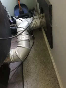

Because the outlet is higher you can lower the hearth or
put a new hole in the wall . Exhaust must go up never down
this allows for natural draft

An EASIER way is to put 2 - 90 Deg pellet vent Pipes together and connect one end to your existing vent pipes, then rotate until the other end is at the proper stove height!! LOL Easy Peasy!

See pic example below of a Harman P68 that replaced a Harman Invincible RS which has a lower exhaust flange.

Although @Don2222 's method will work (and that is what I did for my P43), it is really pretty easy to raise the stove by 6" using landscape blocks on top of the hearth pad. Bonus is that that the stove is higher so getting back behind to clean out the fines box, or work on motors is much easier.
BTW - my P43 is on 2" blocks and has a couple of elbows for the exhaust to match the height because the first stove installed there had aboth a higher exhaust outlet and had about 1.5' of vertical run.
