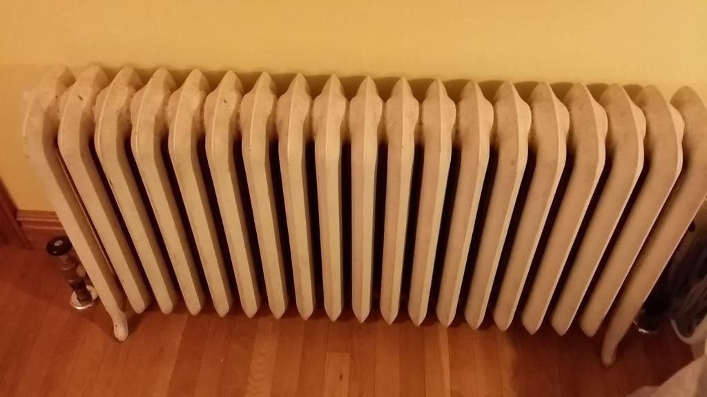

I am running my Tarm HS 4.0 for the first year this year. It heats extremely well. Running roughly 3k square feet. 5 zone system with 1 radiant floor heat zone. The rest are old cast iron radiators. It is a new install. Mostly copper from the boiler to the header system, and pex from there to the radiators. The radiant floor heat is running with a mixing valve.

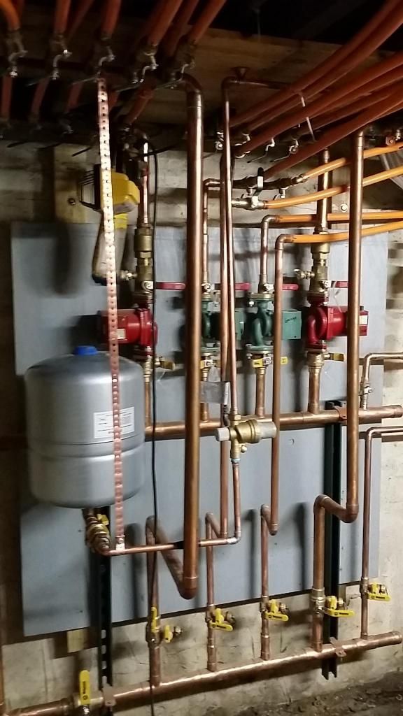

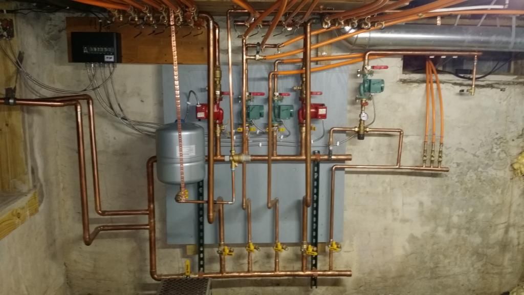

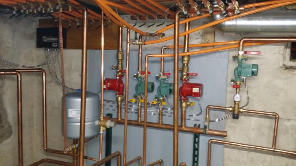

Nice looking set up, turbulator. I noticed that the boiler temp was showing only 40C and I did not see a Termovar mixing valve in the system. Had you just started the boiler? Do you have the mixing valve?
Lots of uninsulated pipe there - where does it go once it goes through the slab?

Thanks Chris. The manifold system is about 20' away, it runs under a crawl space. The lines are uninsulated. What would you recommend to insulate them? The crawl space isn't "cold" but I have no issue putting some insulation on them.

I guess I could supplement the system and run the propane and the boiler....but the boiler heats the room to 73-74 degrees even when the thermo is at 68 due to the amount of water lines in the basement feeding the registers. Pretty much every register has its own feed from the manifold and metering valves...thought about adjusting those a little to see if it helps.

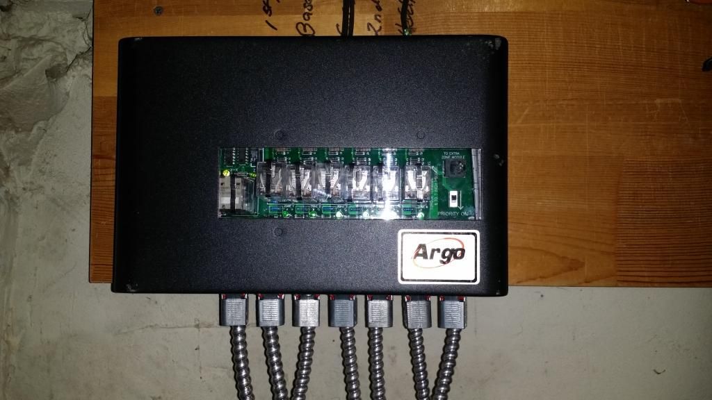

Here are some pics of the manifold and registers, and a pic of the house before the yard was put in. We built the garage and breezeway last winter and also re-sided/roofed the place.
