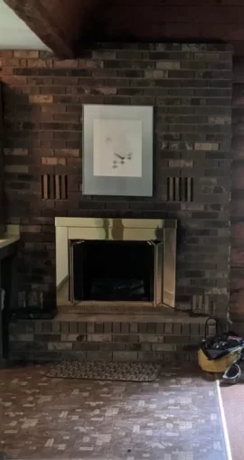

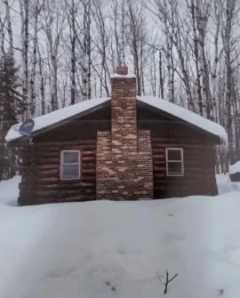

Hi all,
Attached is the house we bought and it is a true log wall small cabin about 550sq ft. The clay tile is square 12”. The house only has electric base board heat so I want to do something to take advantage of the fireplace and I do prefer real wood vs pellet. Thoughts on putting in an insert and like an 8 inch liner or setting in a small freestanding and a 6 or 8” liner depending on the stove. I can get measurements of the inside, but I think it is like 36”.

Having measurements for the inside dimensions are going to be key to finding what you are looking for. For that small square footage, you shouldn't need anything very big. Beautiful place.
Fit the BIGGEST firebox you can in there. Your goal is as close to an overnight burn as you can get.
It looks like a heatalator system, with the side vents, similar to mine, where the PE resides.
You can build a smaller fire in a bigger box, but not a bigger fire in a small box.

Listen to both posts above as they get it right. Insulated liner and make a block off plate. I covered my four vents on my heatilator style and I insulated the smoke shelf area and removed the damper. easy peasy.

Go with a 6" insulated liner and an insert in the 2 cu ft range. With that short chimney I would be looking at the PE Super or Drolet 1800i.
Inside dimension are
front 36 wide and 24 tall and 24 deep and 27.5 wide at the back. The damper is Completely rusted out.

With the small space I still recommend putting in a ~2 cu ft insert or stove. The chimney is on the short side. That is also going to determine the stove. Be sure the liner is insulated and look at units that will work with a 12' liner.

12” stack on just a ~2cu ft stove? Is there such a thing?
