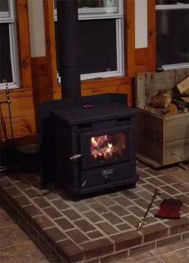

Does your Russo stove look like mine? I live in the Pomfret, CT area. My Russo stove is sitting in my shed collecting dust and rust.
The glass is good, the Blower works and it has the rear heat shield also. You can take the whole thing away as parts for $50.00.

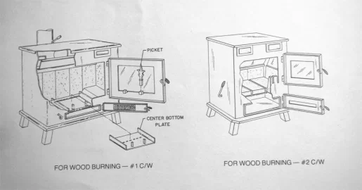

My Russo has 4 fire bricks lining the back.....the bottom has 3 bricks (spaced apart with air spaces for the draft control).....It has a mini steel baffle that can fall down if you hit it with the poker or a log by mistake. It has a customed formed brick cast basin to fit the lower part of the firebox and large front steel teeth. It has the heavy duty bottom "shaker grate" that the bricks sit on and has two pickets for the window .......Hope this helps.............here are some scans from my manual.
  • [Hearth.com] Help with Russo stove
