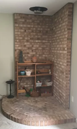

We're interested in getting a wood stove for our 1170 sf ranch-style home, which is currently heated with a heat pump. We will be first-time stove owners. The stove that's made it to the top of our list is the Hearthstone Green Mountain 40 because of its style, big window, emissions/efficiency, long burn time, and soapstone firebox lining. Plus its dimensions and top flue exit fit well with where it'll be installed - see picture of brick surround & chimney pipe.

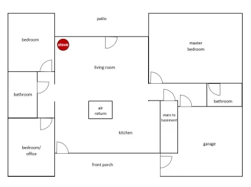

The GM 40 is rated up to 1400 sf, but we're wondering if it would truly be able to heat our entire house (basement excluded) due to the corners/doorways the heat would need to move through. See attached diagram of the house layout. All rooms have ceiling fans, including the living room where the stove will be. Is this a tricky layout for heat to move through? Would moving up to the 60 be better/necessary for heating the bedrooms, especially the master? On the other hand, we're concerned that the 60 would make the living room too hot, which is where we spend most of our time when not asleep. It doesn't get super cold here (40-50F during the day, 20-30F at night), but the house is a bit drafty and not the best insulated. Also, since the heat pump thermostat is in the living room it won't be kicking on to heat the bedrooms when the stove is lit unless we crank the temperature way up. We'd prefer to not have to do that and just use the stove by itself instead.

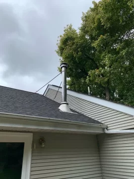

The diameter of the stove pipe is 8", not sure yet what the inside looks like. We're pretty sure there's a wasp nest in there, so we're waiting for a few more cool days so they'll die off before we open it up to clean it out. If it helps, I've attached a picture of the outside portion of the chimney.

The stove is in the center core of the house. It will heat that area well. The bedrooms will be a bit cooler, but that can be nice for sleeping.
The Green Mountain Line is attractive. We looked at it briefly a couple of years ago when we were considering a stove. Have you been able to see the stove in person to look at the size of the firebox? The 40 is a small stove, and you'd have to cut and split some pretty small wood. I think the 60 would be easier to manage in that respect. If you have the room on your hearth, I'd opt to go up a size if you really want to rely on it from most of your heat. I think the 60 is still just 2 cubic feet, and I seem to remember the firebox itself seeming even smaller than that.
Your home layout looks nice from a heating perspective. A stove is fundamentally a space heater, of course, but there are ways to encourage airflow. One trick is to use a small fan to blow cold air out of a room that needs heat and let the warm air flow in to replace it. That could help with heating your master bedroom. I doubt you'd roast yourself out with a 60, and you can always just load less wood or let the fire die down if temperatures are mild.
