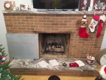

Hello and thanks in advance to anyone offering advice. My wife and I are in the process of a fireplace update and are trying to decide on a wood insert. Our local shop sells Napolean, Jotul, Regency, Quadrafire, Regency, Lopi, Vermont Castings and even a few more. They recommended a Vermont Castings Montpelier (non epa2020) to us today that they have in stock. I can't seem to find very much on this stove other than a few bad reviews. Quite frankly I couldn't find very many reviews period that were newer on any stove. Were looking to heat our home about 1400sq ft ranch with whatever we get. Does anyone have any good experience with this particular stove or should we look at another brand. Would love to burn at least a 18" log if not even a 20" seeing how I currently have around 11 cord cut and seasoned around 18". Again thanks in advance for any insight.
[Hearth.com] Help with wood insert selection.
34" Wide at front
30" H at front
25.5" deep (18.25" height this depth)
20.75" w at rear
*At 18" depth height is no issue and width is 26.5"

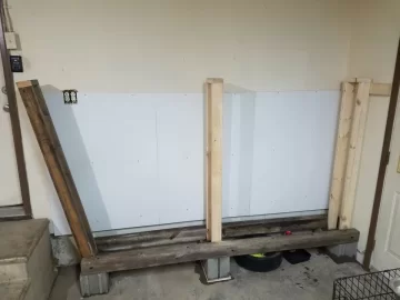

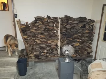

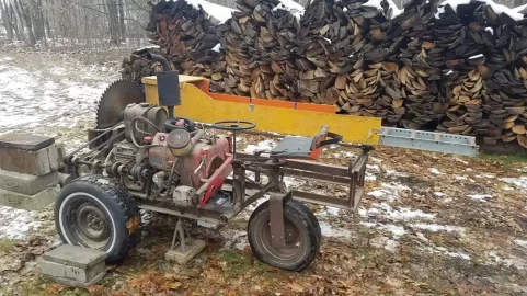

Well I ended up ordering the Lopi Medium Flush Hybrid Fyre and am having it installed February 10th. Built a small rack to move some wood in the garage and a moister meter this weekend. Split some various size pieces and tested in the middle. Most was between 16% and 18% with the highest being 20% all oak slabs that have been cut and stacked for about 1.5 years. First time burning wood. Cant wait.

Good choice. Keep us posted with questions and install results. Keep in mind those splits, while oak, are not real thick so they might not have the staying power of say a 6" piece. I only say that to be careful not to create an inferno with lots of slabs (that have lots of surface area) in a hot box.
Still you look well prepared to stay warm and happy this winter.
Would splitting the slabs benefit me any and help prevent over firing or should I just mix in some rounds?
Splitting the slabs in half will make them burn faster and hotter. Rounds take much longer to season all the way through than split wood, so you will need to use your judgment. If the rounds sizzle and bubble on the ends they are not fully seasoned.
No, do not split them further. What you have is fine in my opinion. Just watch them initially to learn how fast the wood takes off, how hot it burns and how long it lasts. With that much surface area a hot stove could take off pretty quickly. Conversely, a cool stove could shut down quicker since there are not deep coals, or the wood pieces do not stack as close to each other - strangely enough that slows down their burn pattern by duplicating the heat forms.
