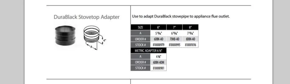

I'd say you probably could use one of these:
[Hearth.com] Help
Dura Vent info:
(broken link removed to http://www.duravent.com/Product.aspx?hProduct=15)
Yes, this is DuraBlack pipe. For 6" round you need the 6DBK-AD adapter.
