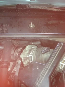

So, this weekend I dived back under the hood to remove the broken sensor, and on replacing everything I have ONE hose that's supposed to connect to something but doesn't! The offending hose end is the one in the photo, just under the right-side wiper shaft.
Car will run about 1 mile then stall out.
The other end, out of sight in this photo, comes off the rear valve cover on the passenger side, and SEEMS to want to connect somewhere in the intake world...
Any ideas, anyone?

Looks like it should connect right there on the intake hose nipple. Coming off of the valve cover it's likely part of the crankcase vent system.
I agree... trouble is, that's not where it came off. The hose doesn't actually reach the pictured nipple- they're a good 6" apart.
Can it be routed differently than how it is now? Unless there is another loose hose I'm pretty sure that's where it belongs.
I'm heading out to futz with it now. Maybe...
Bingo! Found it! Had to play with the routing... it's the #2 vent hose (according to ChiltonDIY) and has a nipple on the flex hose between air cleaner box and throttle body.
