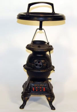

So...I found this cute little potbelly stove on eBay (Attached). It's 22" tall & 11" around. Most likely it isn't really an antique, but I don't care; the look is more important. That said, we have lots of questions!
-- Is anyone familiar with this stove? If so, any idea why it is wearing a hat? ;-)

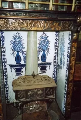

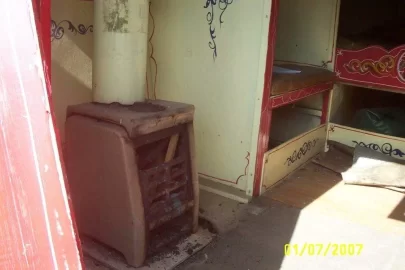

-- Photos of Vardos (Attached) seem to show very little clearance with MUCH larger stoves than this one. If this stove can be more than just a "period correct" decoration, how much clearance would you recommend?
-- Given weight restrictions on our car, what would we need to put under it to protect the floor, which will probably be wood? Would tile around the stove (as in the Vardo photos) be enough to protect the walls?

And here are the other two Vardo interior shots. (I'm figuring out how these forums work).

That cute little potbelly would require 36" all the way around clearance from combustible materials (unless you did some serious shielding) and floor protection beneath with substantial insulative quality extending out 18" all around. And it would have to be firmly anchored. A wood stove in a small trailer or RV is a dicey proposition...regardless of what the real Gypsies did (do). If you're going for period correctness, you might install a non-functional decorative piece. If you really want to be able to use it for heat, then the little boat stoves BG pointed you toward are probably the safest modern alternative to investigate. Maybe a piece for the look, and a little generator and electric space heater for comfort? Lots of possibilities, but above all, be safe! Welcome to the forum, and good luck with your project. Keep in touch. Rick

I'd bet they never heard of NFPA211, or the Underwriters Laboratory, or building and safety codes, either...or they didn't care about them. Shielding can be done in a number of ways, mostly involving multiple layers of materials and ventilated air spaces to reduce the required clearance from combustibles for the specific appliance. You kind of really have to approach the process from both directions...looking for an appliance that suits your fancy, and finding out what that particular appliance would require as far as clearances, and what you could do to reduce them safely. It ain't a simple problem, especially in tight quarters. I'd say it warrants a good deal of thought, though, lest you go to sleep one night in your Gypsy trailer and not wake up the next morning. In concert with my suggestion of an electric space heater was a small generator (gas powered engine-driven). There are small units on the market now that are very efficient and very quiet. Just a thought. Please be careful, whatever you decide to do. Rick

Oops, it only pulled in one photo. Here's the stove:
Um, that stove does not look real or functional to me. Looks like a cast nic-nac as the doors are not functional.
The hat on top....... I'll put $100.00 down that it is an ash tray. ;)
Makes sense, hog. Hadn't even paid much attention to the photo. Might still be an antique...Spark was a real stove company in Oakland California in the 1920's. This cute little guy could even be a salesman's sample model dressed up as an ash tray. Might look good in my workshop. Rick
If it really is just a glorified ashtray, it will become available for your workshop! :-D It WAS billed as a salesman's sample. Would that mean it definitely isn't operational?
In all probability it's a scale model, an historical curio, and not an operational stove by any stretch of the imagination. Rick
Shows what happens when you assume... ;-) I'll let y'all know if there's a door that opens when it shows up. If not, it'll be up for sale and would make a nice ashtray!
