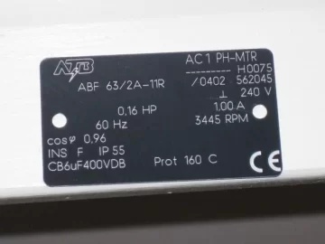

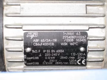

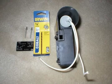

Well here's the conversion kit. I've included 1 closeup picture of the new motor plate and one of the old plate.
The capacitor is glued into the housing, and will replace an identical housing on the motor. I think this is the start capacitor. It looks just like the one on there, and both plates read CB6uf400VDB, so if I'm reading this right, they are giving me a 6 mf. capacitor to replace the 6 mf. capacitor that is already on there?? If I'm wrong here, please let me know.
The drill bit, I assume is to drill out the rivets holding the old plate.
The new motor plate does now say 60 HZ; gee that makes me confident that I now have a 60 cycle motor. They have also corrected the rpm to 3445.
So I draw the conclusion here that the way you convert a 50 HZ motor to 60 (at least according to Tarm) is to change the motor plate to read 60HZ. Am I missing anything?

Geeez I thought the capacitor would at least be a different value. Kinda silly really. They should just say run it like it is instead of
playing games. I would put it the drawer and have an extra cap if the one on it fails. :-S
What did they tell you to do with this 'kit'? No instructions with it? Verbal over phone? Seems like something is missing here/
...still a tempest in a teapot.
We already covered this in great detail. Drill out the rivets, change the plate, change the cap, have a beer. Or not, it will not matter either way.

It's more like I should tell them what to do with this kit. Actually, no instructions at all, just what you see in the photo.

I just noticed that the new label changes the 50 Hz and RPM numbers to new 60 Hz and new RPM. Well, that's what you have, a motor that runs 2800 or so RPM at 50Hz or 3400 something at 60 Hz. Since you're running it at 60 Hz you now have a label that is accurate.
Lots of 50 Hz motors out there running at 60. They run a little more RPM. Maybe some types of motors are affected more by the difference. The new label gives the accurate numbers for this side of the water.
