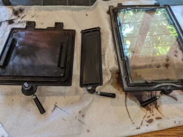

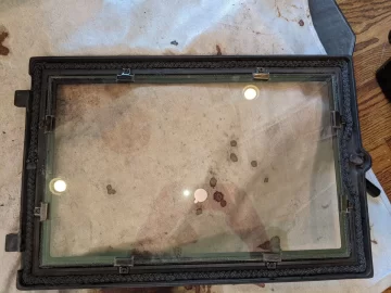

I got the gaskets replaced today. It was definitely time, as the old ones disintegrated as I was pulling them out of the channels. Three years of use on the old set.
Mostly went as planned, though I ended up not following the instructions around how to get the side door off. I wasn't able to get any of the screws that hold the door slider plate on to budge, and didn't want to risk stripping them. So instead, I pushed the hinge pin out all the way and then angled the sliding plate out of its track.

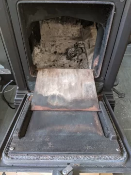

A couple fires with the new gaskets made a big difference. The buildup on the lower corners of the glass is gone, and it seems I need to relearn what primary air setting to use during startup. I guess that means it was leaking more than I noticed before.

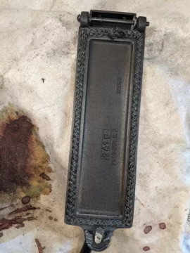

For next time I do see that I'll need to do a better job where the two ends meet to avoid frayed ends, and it looks like I got a drop of glue to bleed through onto the knife edge in one spot, so that will presumably be the spot to fail early. I found a suggestion in the big thread a couple years back (the one talking about all the various kinds of RTV and whether those were a good idea for gaskets) to close the doors on a piece of wax paper the first time. I'll try that if I remember.
