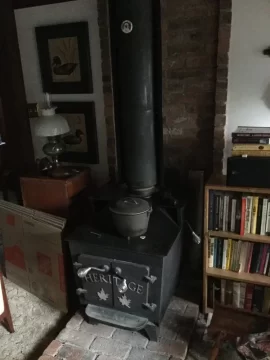

We have the same stove and are trying to get it WETT approved for insurance purposes, but it has no tag on the back. Anyone have suggestions for us on how to get this stove by the inspector?
  • [Hearth.com] Heritage wood stove

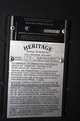

The testing certification tag should be pop-riveted to the rear of the stove. The installation looks poor. Clearances are far too close (30" side, 18" rear) and the hearth is insufficient (it should extend 8" past the stove on each side and 18" in front of the door). Not sure if there are other deficiencies that are not showing.
