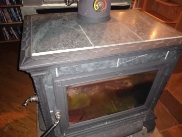

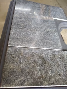

Hey all. I've been through a few Hearthstone stoves over the years, and the family has used them from warming hands, warming dinner, drying gloves, etc. I have a brand new Heritage I just installed and have reservations of putting my beloved heat fan and even the thermometers on the top deck for fear of scratching it. It's absolutely beautiful! The pots, pans, fan all left scratches in the soap stone, which I'm hoping to prevent. I've read about silicone mats? They handle the heat? Just wondering if someone has this figured out. Pics below, removed Phoenix with scratched top, new Heritage I don't want scratched top.
Appreciate the input.

Safe to 400 maybe 450 for food. Just don’t put anything on it. That’s my solution
Not much you can do with the Hearthstones since they polish their stones. Just be careful and use a trivet. With the Woodstocks you can use steel wool to remove scratches.
Well, after watching the above Youtube video, I learned what a Trivet is. Pretty much what I'm looking for. However, now the problem of finding something to put on the cast iron feet on the things. I have a couple old fiberglass welding blankets. Thinking about maybe wrapping the legs with that material, put small hose clamp over? I don't think any kind of silicone will hold up on a stovetop.
Within a week of having my new Hearthstone Heritage, I made a mistake and left the door open with a tiny tiny ember inside which fired up the load of wood I had prepared for that evening. I got a huge black mark on the front of my stove and spent a month looking at it with dismay. Then I read about kitchen countertops that are soapstone and how they are treated with oil. Long story short, I use 900 grit sandpaper and sanded out that big black spot. Recently I put a piece of pizza on the stove top and got oil all over one of the tiles. Sanding it with 900 grit worked a treat. I would think if scratches occur just sand them out and you will be fine. Good luck!
