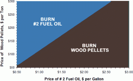

I did some minor research on the whole pellet thing...specifically Pellets vs. Oil. (Propane burners need not apply) And here's what I can't figure out:
At, say, $220 per ton, 4.40 per bag... why the hell are you burning the stuff?
It just about equals out to $2.00/gal oil, which is what my last 2 fills were priced at. Now, I can see if you get your pellets cheaper, say 180-200/ton, or, if you just like the idea. But from a purely economics standpoint, net net its a wash. Unless you are paying significantly more for oil, or less for pellets, I don't see the draw. I understand pellets used to be significantly cheaper, any ideas on future pricing?
Take a look at the chart below. Its generated from the following link:
Energy Selector Link
BTW, This all came about from me comparing coal to oil, which is a no brainer so long as you are using a stoker, which is the functional equivilant of a pellet stove for coal. Then I looked at pellets, an cringed.
You tell me...

<<At, say, $220 per ton, 4.40 per bag… why the hell are you burning the stuff? >>
<<It just about equals out to $2.00/gal oil, which is what my last 2 fills were priced at. >>
If I read the chart you attached right, it looks to me more like $220/Ton = $1.90 a gallon

OK, so let me understand this right......comparing oil at 2.50 and pellets at 220/ton is a difference of 10% cheaper for the pellets - not including the gas to get them, etc.
So, BTU for BTU, a 10% difference. BUT, you are saving 75%.
While I agree there are a lot of factors involved, this type of experience, in my opinion, is either inaccurate, misleading or just plain rare! Perhaps you have a terrible oil burner or inefficient system.
We cannot dispute the basics - a BTU is a BTU. So if you used a monitor (freestanding) oil heater instead of the Pellet Stove you'd probably spend somewhere around the exact same $$ per year. Pellets are not saving you money....something else is.
I only clarify this so that potential buyers are well informed. Having been in the industry for 25+ years, I've heard so many miracle stories - and my feeling is that this can raise expectations. In this case, a 10% savings in BTU to BTU somehow created a 75% savings in heat! There must be more to the story.
