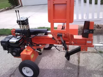

  • [Hearth.com] HF splitters
hope this works

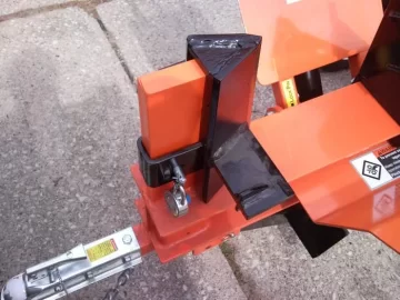

got some pictures up.
yeh the manual says 10" max. I've split about 16" max so far. I also find that removing the pin on the 4 way helps the wood work its way past the 4 way.
Maybe thats all they want to see for to use the 4 way wedge , not sure just quessing . If truely the capacity was only 10 inches what the use of haveing a splitter . Whats the capacity of the log lift does it have weight capacity on there ? I think my timberwolf is like 500 or something like that on the log lift , I would have to look for sure . I know I have lifted 36 inchers on there .
Clarkbar whats the measurement from the bottom of the 4 way to the beam . Just wondering what size splits this thing does . I wonder why they have that pin in the 4 way ?
I'll get that dimension once it stops raining. It's out in my shed. Its about 5" or so. I just remove that pin. It's really just in the way.
