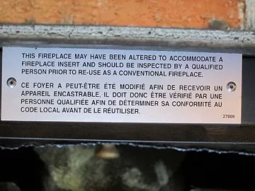

What fireplace is it in? I am glad you are enjoying your new insert but chances are it is not code compliant.
A Marco DWF36. 30 years old, no longer in business. Double pipe straight flue, a 8 inch inside a 12 inch. Flue good and I had a sweep out to clean it before the install. Only repairs needed were replacement of the cracked cast refractory panels which now have to be custom made.
I don't need no panels anymore. I have a label instead - :)
Yeah in the marco manual it clearly says you cant use any accessories not listed for use with their fireplace so no your install is not compliant. Do you even have an insulated liner in it?
Yes you do I read the osburn instructions and quite honestly the fact that they tell you that it is ok to remove the refractory panels is downright dangerous. No matter what the osburn manual says it does not cancel out the marco manual. And putting a tag on a listed appliance does not allow you to alter it and still use it.
