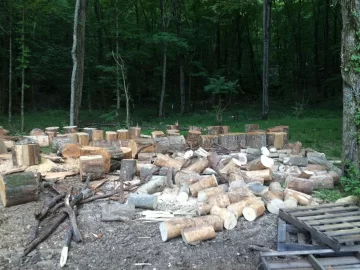

Just bucked and split hickory, white oak, and cherry, how long will it take to season? I live in North Alabama with really hot summers.

[Hearth.com] Hickory, White Oak, and Cherry Link Removed Link Removed Thanks for the responses. Also, should I leave the wood I don't plan to use for the next two winters unspilt or would it be better to go ahead and split it all. Currently, I have split enough for about 1.5 winters.
Split it all. It will actually store for a longer period of time once split. The idea is to get it dry.

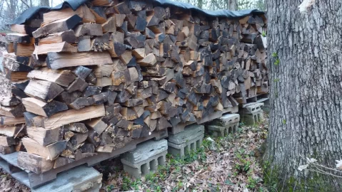

Yep. I would split, stack and top-cover it. The Oak sapwood will hold up better than if you leave it in rounds.
Yea thats what I thought. A friend of mine said he would not split it all because it would last longer in rounds. Also, he thinks that the wood will be seasoned by the winter.
Pass on leaving it uncovered. Birds and rain dump on it, and don't add to its fuel value. Of course, top-cover only.
Moisture migrates something like 20 times faster along wood grain than across it. Consider, though, that once it's split the mean distance it has to travel is much shorter, and the exposed surface much greater. Not to mention that debarking speeds up drying a lot.
Stacking hickory as rounds is a really bad idea. Helps retain moisture in sapwood, and encourage powder-post borers. DAMHIKT

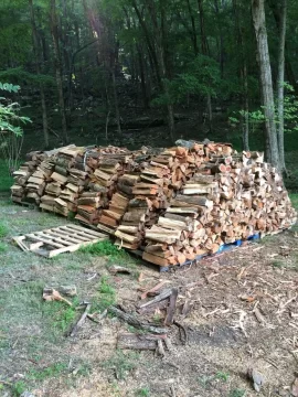

I am about to go now and put some fence post on the ends as caps .:cool: I should have put them there first, but I had to cut down some barbwire fence and pull up the posts. So, I just waited until I got that done.

Yeah, I made that mistake with some Hickory and White Oak I scrounged. I'm about to buck and split some 4' logs I've had stacked, uncovered, for a couple years. We shall see. I've got a dead Shagbark here to get; I won't be making the same mistake with it!
