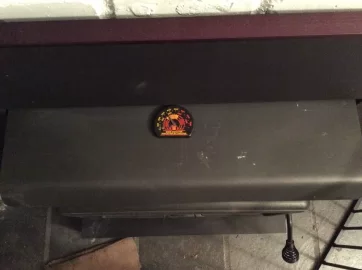

Just in case I missed something here, especially since this is an insert, where is everyone taking there temp measurements from on the unit?
A difference in where the temp is taken can make a huge difference in explaining what's going on or explaining what should be happening.
Just want to make sure everyone is on the same page.

The 2400 has a good surface area on the top plate to keep a stove top magnetic thermometer. [Hearth.com] High temps osburn 2400
Reactions: Huntindog1 and pen
