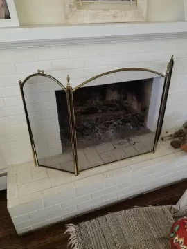

How far in front of the fireplace face does the hearth extend? Can you post a picture of the fireplace and hearth?
Thanks Begreen, Attached is a pic of how it is set up. The front ledge extends out 15 inches from the opening of the fireplace. the front face of the hearth is 1 ft tall exactly. I guess if it is necessary for more heat i can extend it out, just not sure how much work that entails, and was hoping to get away without extending.

That's very helpful. You will be able to extend the hearth with simple ember protection. This could be as simple as a sheet of metal, tacked to the floor or a basic hearth extension board. Due to the shallower nature of the fireplace, I would look at inserts that project a bit out onto the hearth. Unfortunately, the options are changing due to changing EPA regulations. An Enviro Kodiak 1200 looks like it might just fit, but they don't have a 2020 ready stove. The Lopi Revere insert might just squeak in there. Measure that 20" again to be sure. The Country Performer C210 insert is 19" tall, now sold under the IronStrike brand. It's a good insert, but it will project out onto the hearth 9". This is not a big deal with a simple hearth extension at floor level.
