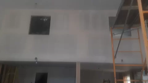

Our new construction house has R44 walls and R60 ceilings. The living space is 1,300 sqft including a loft for the bedroom and an attached shop that's 1,200sq ft with 16ft walls. Our question is how big of a stove to install and will heat all 2,500 sq ft and not cook us out. There is a door into the shop from the first and second floor that can be opened to heat it. We live in the mountains of Alaska with an average winter temps of about 10deg last years low was -30 for a week.
Initial thought is that I would consider a 2 stove or 2 heating units setup. Load up a few pics of the place. Include the interior layout. Naturally we will need a few pics of the scenic mountains of Alaska as well:cool:

The shop in the winter will just be for personal projects and parking my husbands work truck. We are up at Hatchers pass in Wasilla. We get lots of snow and it stays colder than in town.
How does one calculate how many BTU an hour we should aim for? I know last summer I found a site where I could calculate our heat loss at various temps and it was next to nothing. Guess I need to find that again.
The fireplace stores are saying we need like the BK king because of the sq ft. But I have talked with energy people from the cooperative extention both here and NY they both thought a big stove would be hard to run efficiently without over heating the house and maybe smaller but again had no real idea how much smaller. I love being warm but not back in Missouri summer warm.

Beautiful beautiful place. Heating my wife's car back up to household ambient every night after she parks outdoors at her office all day is one of my largest single BTU eaters. Can you wall the garage area off from the shop, or not so much?
I don't know how to calculate it. I heat 1200sqft in Fairbanks with R40 walls and R60 ceiling. ~40k BTU/ hr is enough to get the place warmed up when it cools off, and a stove that can be turned down real real low will keep from cooking you out.
Once it's built you could get an air door test to see how well sealed it really is. Another useful thing to know is your degree loss per hour. If I turn all the heat sources off my house will cool from +70dF to +69dF in about one hour when outdoor ambients are in the zero to -20dF range. Below -35dF i start losing many degrees per hour and have to generate a fair number of BTUs.
I personally would plan to heat the shop separate from the house. On paper you could do it all with a BK King, but that kinda sorta means having an overhead garage door in the dining room.
