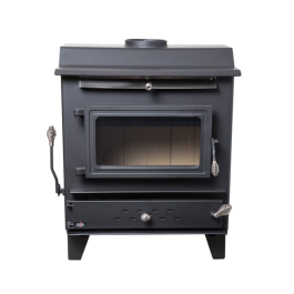

Looking for a Hitzer model, no blower that one can heat water to a point of sterilization (180F), in case of emergency.
Does anyone have a Hitzer 354 without a blower? Does the top get hot enough to boil, or at least a good simmer? Would burning wood get the top hotter than burning coal?

They are out of stock at the moment and looked them up and have a picture of it for you..
They are sure not cheap and over 2,000 dollars and more...but the ad reads real well.. I do not know anything about stoves but just knowing that some people want a variety of options..bhollar is well experience to give opinions --not that I can agree with at times--but well experienced here...That stove to me looks just beautiful and I am learning about coal heat too....old mrs clancey

Thanks, we are just trying to find the best option/model from them. One thing we want to be able to do (in a pinch) is to heat up water on it. We kept using the word "boiling" when asking which ones they would recommend, when we visited them in their shop. But really we should have used the word simmer. Basically 180F+, that is why they recommended the 55 or 82. I like the looks of the 354 more, but they didn't think it would be able to "boil" water.
