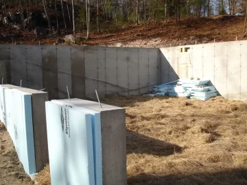

I put 4" of foam around the whole foundation. 2x8 walls with another 3/4" of insulation on the inside to help the studs. Lotsa insulation in the attic. When you do the math on insulation it pays back pretty quick. It was only $1,600.00 to go from 2x6 (min code) to 2x8.
