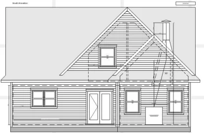

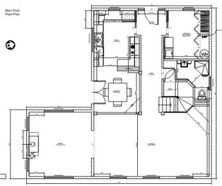

When I was designing our home there was much heated discussion WRT the location of the hearth. My wife wanted it more central arguing that near the central stairway was the only way the heat would reach all areas of the house. I was sure that locating the stove at the far end of the ell would work. It does.
{edit} added a south elevation
