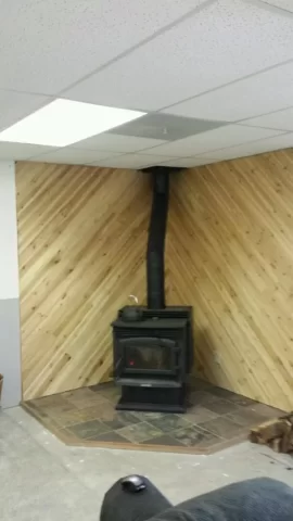

I have found my way back to the hearth forum thanks to a member here (JRHAWK9) who as it turns out practically lives in my back yard. He was gracious enough to show me around his place and show me his burning setup. Very impressive :). Anyways, during our conversation I mentioned that sometimes I get an overdraft on my enerzone 3.4 and the thing just runs away (even with it completely damped down). I'm not running a temperature probe in my flue (soon to be rectified), just a stove top and when the stove really gets rolling I can get temps on the top 800 degrees or more which really scares the crap outta me.

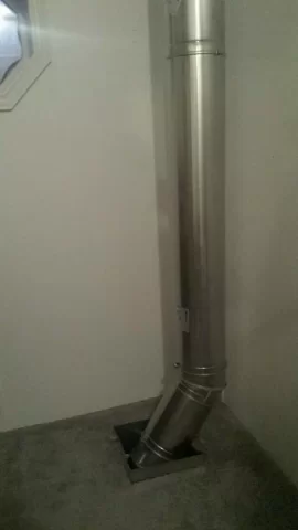

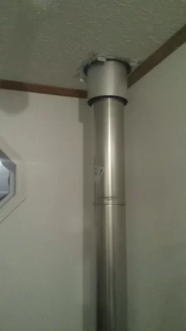

I think I may have answered my own question. The black double wall pipe doesn't have insulation? My installation is in the basement. I have black double wall from the stove going up to the ceiling of the basement, where it goes into a ceiling support box. Once it exits the box the flue is stainless steel which goes through the first floor and then through another support box into the attic and out the roof. I remember the installer saying there was insulation in the double wall, do I assumed the black pipe had insulation in it as well.
So if that's the case, I should be able to just punch a bit through the black double wall, install my probe thermometer and the manometer probe. I'm probably making this more complicated than it needs to be :)
