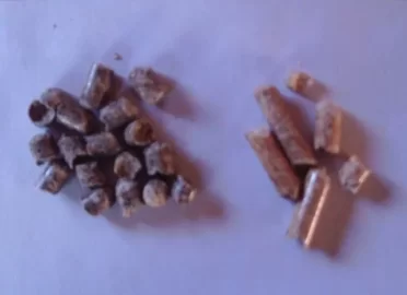

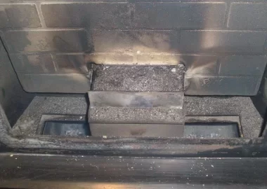

Had a hopper fire this morning in my Canadian Comfort Ind. pellet stove...the hopper door was closed and it was basically a smoldering mess with an extremely large quantity of smoke. Video here:
The stove had just been cleaned yesterday afternoon and the vents cleaned last week...had just bought 2 bags of pellets from Tractor Supply Co. yesterday and filled the hopper with one of these after yesterdays cleaning...but had previously been using Okanagan Platinum pellets with no problems. The TSC pellets were very dark although I've burned TSC pellets off and on this winter as well. I'm posting a picture of a comparison of the Tractor Supply (left) and Okanagan pellets (right). The burn pot was completely chock full of ash (second photo). I literally had cleaned this stove out less than 24 hours previous.
So my question is, how did this happen? The TSC pellets were stored outside and I'm guessing were possibly damp? The TSC pellets in the photo are pretty dark and were taken from the unopened bag I have left over...although the pellets which didn't burn in the hopper were lighter, maybe the heat from the fire dried them out. But it looks as if they didn't burn so hot and clogged the chute with pellets which smoldered all night down the auger.
Is this a correct diagnosis of the problem? Or could there have been other factors? I am trying to decide what to do about the stove as it did have water poured in it to put the fire out. If it is still working I am not sure I even want to use it, truthfully.

Did you by any chance hit the damper? Such as closing it down can lead to burn pot pile up as can other things such as not getting the stove's internal exhaust passage ways and the combustion blower and the cavity it sits in clean. Also a failed or failing gasket or door latch.
I am no expert but I had an incident that could of been like yours. I am having combustion issues,so what ends up happening is my pellets back up in burn pot and pile up and up to hopper chute,I am still battling my issue waiting for gaskets to arrive.Is your stove burning well...ie torch like or lazy flame? I have never heard of anyone having a hopper fire,maybe it happens...So my help is of combustion and burn quality.
Looking at the pictures it looks like a air issue(darker colored ash and stove interior). How old of stove? Poor or failing door gaskets?
Definitely did not hit the damper but the door gasket might be a good clue, thanks...going to take a close look at that. Is there a good test for the gasket (i.e. shut the door on a dollar bill and see if it can be pulled out etc.) or just by sight? It's been burning okay up until this batch of pellets, although I've often complained about the lack of heat from it ("glorified hair dryer" has been a term used a lot lately). I didn't put like a whole bucket of water in the hopper--just enough to put out the embers and the unburned pellets soaked up any excess very quickly. I'm not seeing any discoloration of the hopper sheet metal other than black scortch but there surely could be damage I don't see. I have the stove running on empty and the auger turns fine and doesn't seem to be binding on any warped metal. No idea the age of the stove and no model number readily discernible. The door glass has a lot of black soot on it too...I noticed that as well. From my engine tuning experience that would indicate a rich fuel condition, but I don't know jack about pellet stoves. This is my first go-around with one in a house I just bought. Not impressed.
The pellets did back up in the burn pot and the chute I think, and when the fire went out it just smoldered up to the auger and the down the tube to the bottom of the hopper. There were a ton of hard deposits in the burn pot when I cleaned it today.
Clogged venting - failing CA blower - Something is amiss.

Improper air flow, not going through the burn pot as it should but sneaking around the door gaskets can suck the cooler room air thru the stove and not the hotter air of the burn pot.
Yes try the dollar bill test on the doors or a flame from a long nosed bbq lighter works for some and see where the flame draws in around the doors.

The dollar bill test all along the gasket. it should present resistance.

Vents were fine, checked 'em just now...the whole shebang was cleaned last week and the stove itself was cleaned yesterday. Yeah I have a CO detector within 10 feet of the door to the room where the pellet stove is and smoke detectors throughout the house. The stove was actually running all night as it has been for the last 2 weeks, so I don't know when the failing started. Everything was kosher late last night.
Did the dollar bill test...barely any resistance on the door gasket!
If the hopper lid is kept shut and no one tried short changing any of the clearances during the install the normal issue is the smoke and such, not flame. There have been others on here this season.
One of which is up and running after correcting some items and having everything multiply checked and inspected. One the owner decided to remove the stove. There were others I've lost track of.
If you decide to put that stove back in service I strongly recommend that a trained technician for that stove go over it in detail before you turn it on both to check the stove for damage and to verify everything is installed correctly.
