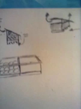

Thanks for the video - it looks exactly like what I sketched out on my 'post it' note! ;-)
My wife overheard it and all I got was an eye roll so I'm going to take that as an ok! :-)

Thats a very complicated solar kiln. I think I will stick to my polytunnel version at least I can load it up with a tractor or fork lift and I dont have any ongoing fan costs.
I think a kiln would be a pretty neat project - make it big enough that you could open a side of it & load a pallet or two in with a FEL and Red Green's your uncle.
Aren't there solar powered attic vent fans out there? If you could tie one of those to a humidistat (out of a dehumidifier?), you'd pretty well have automatic humidity/fresh air control that uses no electricity.
I had wondered why he hadn't used a solar fan as the kiln obviously faces the sun? My space doesn't allow for a palet depth but I could make it twice as long as this. My colleague is a techie genius and is helping me put together a special needs sensory garden that will have solar and wind powered stuff so maybe he could knock up something! I also like the poly tunnel idea but without the space would the tunnel get the correct blow through?
There is a simpler yet still effective solar firewood kiln. The clear plastic is held above the wood by a framework of some type. The only ventilation is an opening around the bottom. Water vapor condenses on the plastic and drips to the ground. It is important that the plastic not touch the firewood at any point.
This simple type of kiln can reduce seasoning time by greater than 50%.
