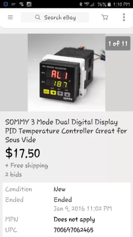

Depends on where your manual says to take the temps readings, mine says to take them top front center. I ordered a PID controller and a thermocouple and have it bolted down to the top of my stove using my draft test port bolt. Screenshot_2016-01-13-13-10-47.png
The design of my stove and the warming top does not allow me to use a magnetic surface thermometer without having a friend water jet the top grate to allow it to sit over one. I also was able to wire in a flashing buzzer as an alarm if the stove gets over what I feel is a safe set temperature.
