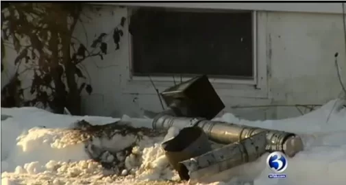

I would be interested in what Smokeythebear has to say about this after he watches the video. From what I can see the venting looks interesting.
They never provide decent pictures of things and the only way you'll find out what caused the fire is to get a copy of the fire marshal's (or fire department's) investigation report which are public records. It is rare for the media to do a follow up on such stories.
Interesting color inside the termination cap.
I can't say as I care for the up portion being outside but as long as you keep up with the cleaning there shouldn't be an issue.
Not much to go on from those pictures and stuff has been moved or removed
I guess I'm a little surprised the fire extended into the walls so quick. Something had to be opened, like the hopper or the firebox or at least a leak in the venting in order to spread. Perhaps a shopvac with hot ash next to the stove. Who knows? Like everyone is saying it is difficult to guess what happen. Too many variables. It would be nice to know so we can learn from others misfortune.

Sure is tough to say what happened, but the news said flames were coming from the pellet stove! ! ! I do not like installs with outside vertical rise, it should be on the inside.
Interesting part about that is, I worked on a Thelin Gnome stove and the inspector said because it is a prefab Modular house and the vertical rise MUST be on the outside!
Then I started taking the pipe off the stove and the inside thimble fell off because the screws did not hit a stud and there were no anchors! LOL Something the inspector missed but I fixed it!

what do you mean by the color inside the term cap?
Those are preferred over black (a little black is one thing but there is too much from what I'm seeing).
You do have to make some allowance for start up and shut down, but that looks like too much to me.
if the stove was the source of the fire or even if it was not but maybe to a lesser extent , the fire event prob changed the color in the vent ?
looks to be of adequate or even oversize diameter no ? looks like 6 inch ?
lets say it was the stove , i assume a dirty burn could/would lead to a chimney fire if never cleaned ?
if the vent was undersized or oversized ,what would the typical results/sympoms be ?
new guy , just trying to learn
We don 't have enough information to tell what happened and why.
That vent seems intact (from what we can see of the picture) with the exception it has been pulled off the stove and out of the wall.
The fire may have been from inside the stove or from an ash container we don't know and the video is not providing any real information.
We have seen times when ash was disposed of by placing it in a pizza box and setting it on a deck, or the venting had a joint inside the wall or inside the house near the wall and the joint separated, there are also at least two recent threads on here of hopper fires that the owner was asking for help to fix and so forth. Just not enough information to go on in this case.
Undersized venting usually leads to poor burns and a lot of ash build up, ash build up is a very bad thing.
Oversize venting can also lead to poor burns etc .... but to be over sized you usually have to exceed 36 square inches of cross section and have bit of length.
