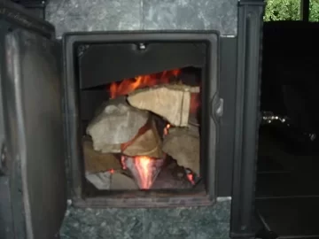

I didn't even consider measuring to the glass, that is not the way you are supposed to burn the stove. Approximately 10" deep is the usable firebox depth on the heritage, there is a substantial lip right where this point rests at the front. I fill the box, use all of it. If you are willing to load against the glass then you might get a little more just like if you loaded above the baffle somehow.
  • [Hearth.com] How big is your stove.... really.

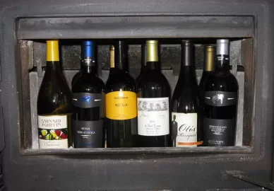

I prefer to look at it this way.

Beetle-Kill said:
Nice BeGreen, nice. And for those Coor's drinkers out there- the creek that runs to the plant in Golden is fed by the creek that runs through my place. I pee in that creek.
Thanks. I didn't feel like hauling out a ton of bottles, but checked and found that allowing for 2" behind the glass, this is an easy 6 x 5 or a 30 bottle firebox.
