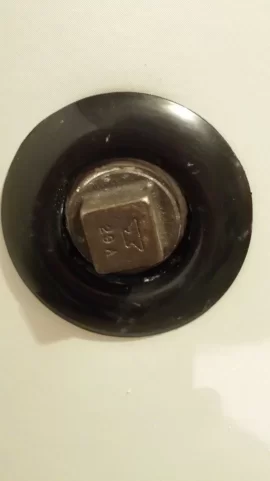

I have three of the 1-1/2" plugs seen in the picture below on my buffer tanks. The heat loss probably isn't that huge, but I still think about it. :) The jacket is something like vinyl over a 4" thick flexible foam. I haven't been able to think of a way to insulate them in a good looking fashion. Maybe someone out there has?

Your doing really well if that's all there is, my boiler room is full of unfinished do dads! How about a PVC pipe cap that is the diameter if the black bushing with insulation
I guess I pass one of these doo dads several times a day and am drawn to touch it. Strange, I know, since they can be pretty warm. :)
I'll look into the pvc cap idea-it'll probably involve traipsing around HD with a pipe fitting.
Cut a 4" long piece of insulation and put it around the plug, Then cut a circle to slide into the end. Find a pice of copper or steel tube the correct diameter and punch out the circle to get a nice clean cut edge for the circle plug.
Cut a circle out of some black armaflex and glue them on there.
I do have some 1" thick Armaflex insulation for 1.25" pipe. I think they do make sheets of it that I could use some of that elsewhere.
I'd still like to keep the bushings, I think.

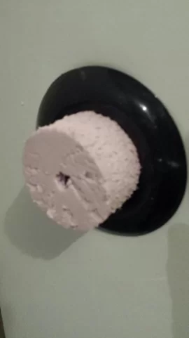

I drilled a plug out of xps and carved a squared chunk out of it. It fits snug and doesn't fall off, but not the ultimate, I'm sure, even if it was painted. :}
