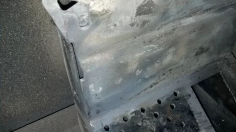

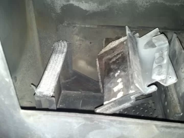

The pot shouldn't be "Filling up"? Have you put any furnace cement in the upper holes of the pot (do the very upper rows on the sides and the upper 2-3 rows on the back pusher plate and front door. Use a 2,000° furnace cement. Clean pot well and wipe down. Then massage cement into holes) This will give you more airflow under the pellets, where the combustion air is needed.
(Pics show the upper row on the sides of pot filled. What it looks like from both sides. Also, you can see the gasket material I added to the pot receptacle and back sides of pot to seal the gaps)
