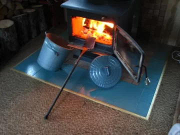

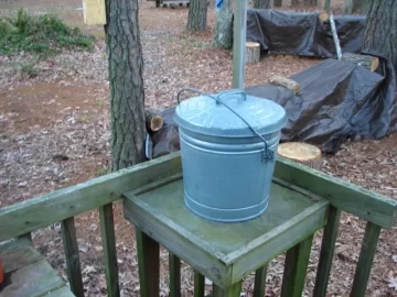

I put an extension on my shovel handle (to keep from toasting my widdle pinkies) and push the coals to one side and scoop out the ash. Push coals to other side and repeat. A home depot can with lid that is held on with the cans handle, then goes to the porch onto a table with a stone top. Done carefully, most of the fly ash goes up the flu : )

Open the damper, bypass, and whatever else to increase the draft... hold your can tipped like the guy in the pictures above near the door of the fireplace... and shovel away... the light stuff should suck back into the stove and be careful with that bucket until you get it somewhere you don't mind burning things...
