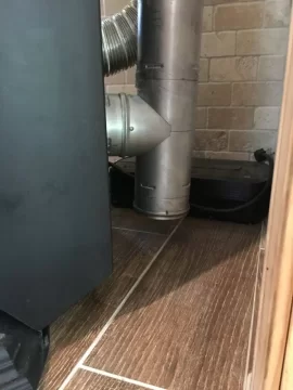

So when the tie comes, how will I clean this? Seems to me the clean out tee should have been installed outside rather than in?
Yup, someone didn't think ahead on this one.
I have a corner install with my stove with the clean out T inside, but I have a lot of room between the walls and stove to get to it.
Without seeing the stove from the inside and how much room you have to work with, I will say this.
You have two options.
1. If you have the room and willing to do the work, make the hearth pad larger and move the stove away from the walls so that you can easily get to the clean out T. This option will take some work but you will still be able to use the existing holes in the wall for the exhaust, you will just have to extend the exhaust and FAK pipe.
2. You will have to rework the wall thimble so that the exhaust goes straight out and put the clean out T outside.
I prefer mine inside so that when it is below 0 I don't have to worry about fighting the cold to clean it out. To each their own, but if you have the room I would really try and keep it inside and just extend the pipe.
Good luck, stay warm and let us know how it works for ya.

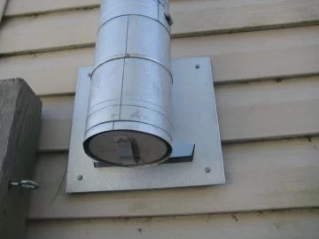

ok... here is my setup and this is what I do... Can't see it but the exhaust drops down about 6" then into stove.
from the outside, i use my 3" pipe brush and push the ash or residue in towards the stove..that's right.. towards the stove..
all the ash will drop down into the elbow inside..[Looks like u can disconnect your outside silver pipe.]
then i go from the inside with my shop vac and go thru the exhaust tunnel and get all the crud that i just pushed in..
i Use a small 2 gallon shop vac and use the flexible hose.[NOT a stiff exstention] so the hose will bend a bit at that tee..
small shop vac will have a smaller diameter hose that's perfect for going thru the exhaust tunnel.
BTW: Not my brainstorm.;)
read this tip couple years ago here..

Pix above is my exhaust with the OAK .flap opening behind the cleanout cap.

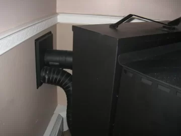

I think similar to what Tonyray said, I usually brush from the outside and go through the stove with a flexible hose to vacuum out.
My tee is installed on the inside similar to yours (see below) but because I did not need a hearth pad and opted out of the leg extensions my T is there but to close to the floor to actually open.

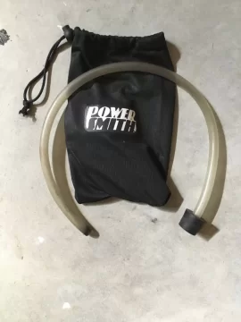

PowerSmith sells a pretty cheap assessory pack for vacuums that comes with a flexible hose attachment. I think I got mine from HD for $15.
