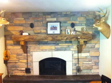

Did my cultured stone like this and this is how we trained contractors that bought stone from us.
I did a "wet" coat, no scratch, no dry, and also buttered the back of the stone and set in place, a little wiggling back and forth to work it in, and done. The only scratch I left was about 6 or 8" around the perimeter of the stones that were installed and scratched. Then when restarting next day, wet the scratch and wet coat , butter and set more. I used the mesh to scratch with, and used several different mason trowels and a pointing trowel to get in the crevices and scoop the slop out. I used dry stack ledgestone so no real mortar joints.
I used masons mix type S mortar. All bonded excellent and worked well.

14" Finish trowel I used to mud the wet coat on the mesh
7" Gauging trowel to butter the backs of the stones.
