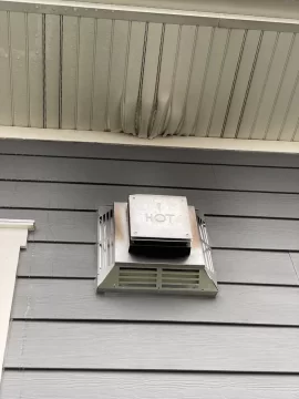

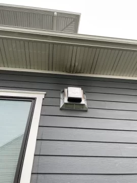

Hey All,
The other day I was out in my yard and noticed that my gas fireplace vent has melted the soffits on my overhang. Based on the picture I measured out approximately a 20" clearance. Not sure how long this has been happening for as its the first time I've seen this. I have a Majestic Pearl II Peninsula gas fireplace. Any suggestions on how I go about fixing this? Thanks in advance.

Check the install manual...
The overhead clearance to vinyl soffiting is 30 inches,
according to the install manual.
Pic is below
1. If the siding is vinyl, you need a vinyl siding standoff.
It will bring the cap further out from the wall.
2. you can have somebody fabricate an upper heat shield for the cap,
which will direct the heat further out.
3. you need to open the air-shutter more, if you can.
That will minimize the sooting on your siding & soffit.
It will bring the cap further out from the wall. - the siding is hardiplank and doesn't look like that is damaged or warped
which will direct the heat further out. - i'll look into this
# you need to open the air-shutter more, if you can.
That will minimize the sooting on your siding & soffit. - do you mean the air shutter on the vent box? sorry, i don't know about these things so apologies for silly questions.

Hi DAKSY - I spoke to a authorized dealer and they recommended replacing the damaged soffit with a non ventilated metal soffit. What do you think about that? Should I go for a fabricated heat deflector as well as a metal soffit?

Your call. Will you replace the ENTIRE soffit?
no, was just planning to replace the soffit around the damaged area. Its on the side of the house so not sure i care too much for how it ends up looking.
Ok. If you don't add the heat shield, you may end up damaging the
siding directly above the cap. That's why I recommended a Vinyl Siding Shield.
If you also want to use aluminum unvented soffit, go for it.
Reactions: meh
Good point. This may be a silly question but would the heat shield act as a sort of ramp for water to flow down into the vent?
