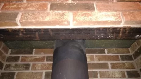

The living room has a nice hearth area made of natural stone and the single wall stove pipe comes up out of the top of the stove about two feet and then goes back to the wall whith the chimney on the other side where it enters through a big sheet metal thimble about a foot and a half in diameter that covers the surrounding Sheetrock of the living room.

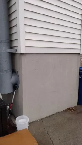

I wanted to ask to everyone, is the new stainless steel insulated liners, are they mandatory now if you put in a new stove, or are you allowed to use old piping, like mine, which is like a thick galvanized steel?
I read for zinc exposure that steel needs to be heated to 1100 degrees, but my stove only uses that steel on from the tee piece and up. They use only the same black steel as my stove on the inside.

Are you talking about a class a chimney system of a masonry chimney? Where is the galvanized pipe?
This is outside, the part I want to know if people generally are mandatory to change out:
[Hearth.com] How do I know if I need a liner?
This is inside, if that Tee piece at bottom of galvanized steel comes inside at all, its covered by that piece of metal.
I plan to get a quote this week, and maybe a city inspector, so I can see full cost for a brand stove from his store and his new professional install, or buying a stove from home depot and installing it myself with my current pipe, or buying a new kit if a must have.
WHat you have is totally different than what the poster is referring to you have a class a chimney i am sure the inside is stainless
Oh he didn't have pictures so I thought we might be talking about same thing...at least I didn't need to make a new thread >>
