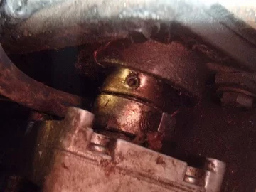

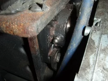

Thanks so much everyone for trying to help me. I'm sorry it took so long to get back to this. mchasal I had seen that pic and still couldn't figure where the wrench went. I finally had the stove shut down today and could take pics. This is the screw I was asking in the the first pic or is it the second pic?

I believe the bolt needed to be removed is the squared one. The set screw is on a bearing collar. Maybe Mike can catch this thread and correct if needed.

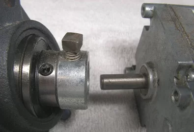

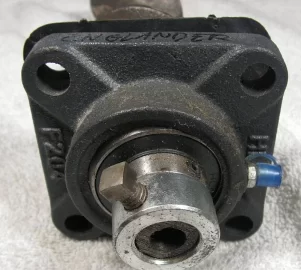

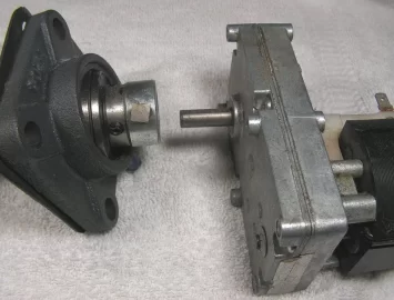

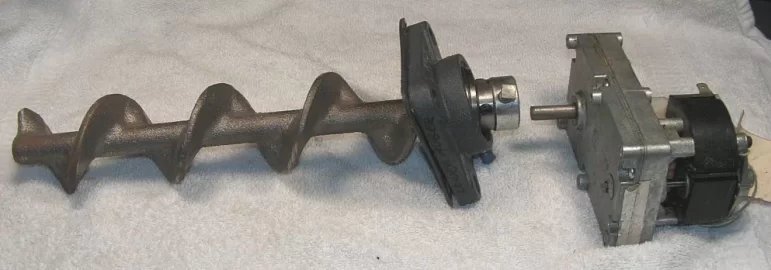

Hi Margo, Don222 above gave you the right instructions. Here are 4 pics showing your auger and auger motor unmounted with connecting bolt on the auger end.
The last pic shows your auger without the 4 mounting bolts in it. Unplug your stove #1. The motor leads unplug( pull off) from the terminals, then you loosen the large square bolt that holds the auger motor on and pull the motor off( backwards). Then you unscrew the 4 bolts that hold the auger into the stove. Then you can remove the auger by pulling backwards, careful of the gasket on it also. Do everything in reverse to reassemble. Just make sure that the 2 augers aren't grinding against each other on the ends where they meet in the hopper bottom, there should be a free movement between the auger teeth. Good Luck!----Lorne.
P.S. click on images to enlarge them for detail.

Oh my gosh I see it in my second pic! I never saw that one somehow weird. The thing I was looking at I think was covered with a blue cap in your pic.
That's a bearing grease zirk that's got a blue cap. Good luck
