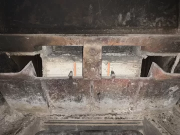

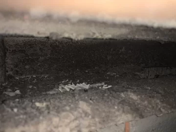

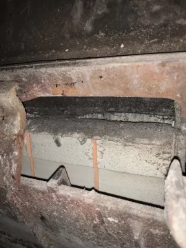

Got it apart although this thing definitely has had some tinkering done before. Throat plates held in with a retainer using an Allen bolt. The bolt is also stripped so it won’t thread out anymore…making the throat plates uneven….cat looks half there and half not.
I’ll attach the photos I attempted to take. I’m guessing this isn’t great?

Yeah working on those usually involves drilling and tapping holes and generally atleast a few replacement parts
Based on those photos of the cat, is it usable? I know I can find a replacement grate online but as you’ve said, it’s not worth going whole hog.
I would say probably not any good. I wouldn't bother with the grate

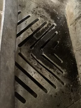

$332 bucks to replace....guess it's nice that I can just leave the grate....not sure if this is worth trying to replace...I don't even know how TO replace said item. Considering it was from the 90s maybe the manual shows the process.
You just lift the grate out and drop a new one in I believe
