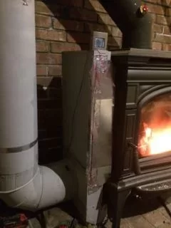

here is my set up
1. 10" in-line 400cfm fan in ceiling sucking through a 20x20 filter
2. custom made sheetmetal box hugging the stove with 8' return suck back to my furnace and i average about 150* about 5' up the pipe. will posted again when i clean it up and paint it

Don't bother reposting. It is against NJ code. Fly that by your insurance company you did, right?
That's cool but a lot of my old folks engineers designers published writer old Mother earth news Folk Etc have a lot to say about building Codes 2 I do understand that allowing common sense guide one is no ok as common sense is not really common.. why I live wayyy out of the building code range But my house is insured (not fo much) I get engineer variances all this info goes to ins. co...

Your fan will last longer if you find a way to 'push' the heat instead of 'pull' it.
Ask your local inspecting authority about attaching a return to a wood stove. And when all else fails Read The Manual. Might be good to call Lopi too and ask how this affects the warranty.

It is more efficient, legal and safer to blow the cooler rooms' air toward the stove and often more effective.

For sure one has to consider code because if you don't and should a fire happen, your insurance could get out of paying you a thing because you are not to code. This goes for the setup of the OP and also for the old style registers.
The problem is if you develop a leaky stove and start sucking CO and pushing around your house. It might seem like a good idea but it is really unsafe. I believe code is no return air duct within 15ftof a solid fuel appliance but I'm not positive.
