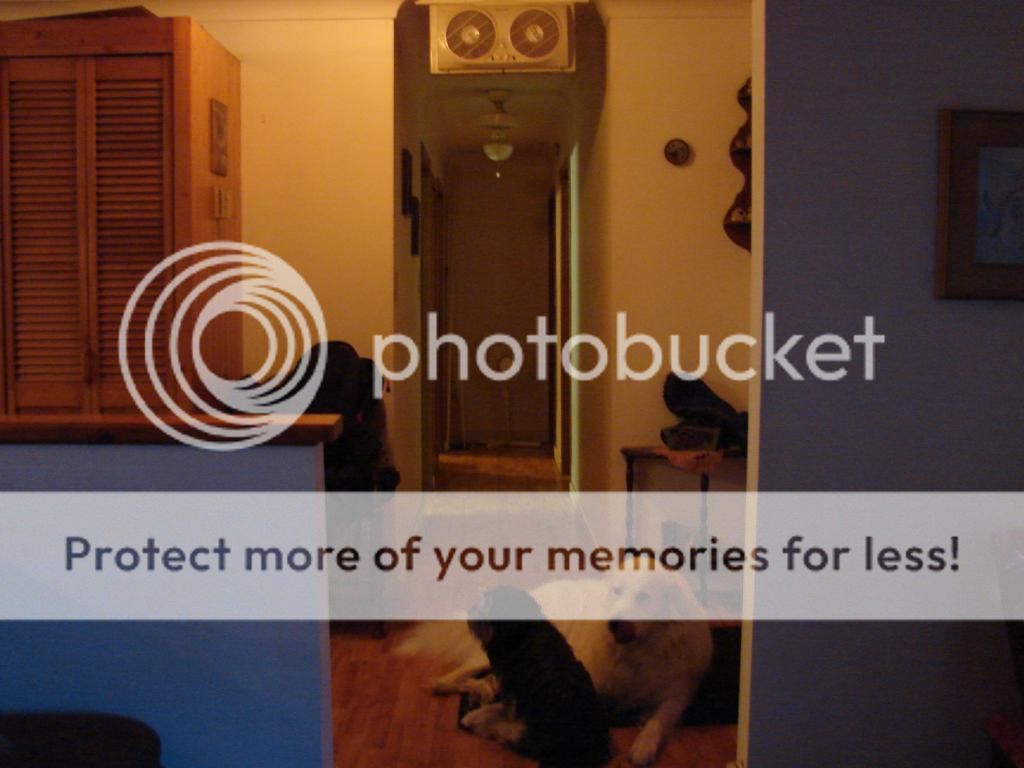

Question about circulation...a lot of you guys mentioned setting a fan on the floor blowing cooler air so the warmer air circulates higher creating a loop. I need to do this on a higher floor. I have the insert in our cathedral ceiling great room with a 25' ceiling. It opens up to a hallway above and that hallway closes off once you get past the wall of the greatroom and leads to the other spare bedrooms and bonus room over my garage. This is the furthest and coolest part of the house. So far i've put a fan at the beginning of the hallway right above the stove to push the warm air down the hallway towards the spare bedrooms and bonus room. Would it be better to put a fan on the floor of the bonus room blowing cooler air down the hallway towards the great room that has the insert even though this is one floor above the stove room and that cool air isn't really blowing 'at' the stove? I'll try to upload some pics so you can see the hallway in relation to the stove. The insert is below the tv in this pic
(broken image removed)
Yes, give that a try with the fan down low on the floor. We have a master bedroom that has a similar issue. I tried the low fan blowing out into the warmer hallway and found a 5 deg increase in the room in about 30 minutes.
