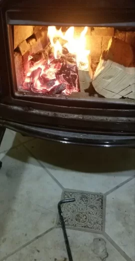

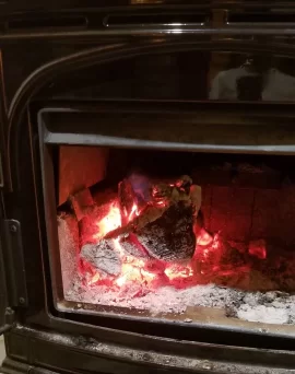

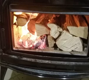

I am going to have to run soon. I'll get some pics up in here later for sure. However, I have noticed the more I disturb the existing coals, the higher my particle counts in the house get, and raking hot coals to the front is no bueno if you are trying to keep your indoor air clean.
The other step that works for me is to, sometimes, as soon as the loading door is open, use the biggest split I am planning to load first as sort of a bulldozer to push all the glowing coals to one side. I find raking the coals out into an even layer on the floor invariably puts a bolus of particles into my living space, and these can very rapidly start pushing visible smoke out the loading door. Keeping the coals tight (getting the coals tight with the bulldozer split) seems to reduce airflow over the glowing coals that lead to increased particle counts and sometimes visible smoke rollout.
If I have my hands full because of time constraints it seems to help to start piling splits into the side opposite the bulldozed embers. It seems to me* (not a physicist) the loading door can let more air into the firebox than the chimney pipe can suck out. When I block incoming air with new fuel, the total airflow into the firebox is quickly reduced and smoke rollout is less.
For highest possible rollout, the most possible particles into my living space, the things to do are going to be disengage the combustor, open the loading door wide open right away, rake all the coals around two or three times and then dilly dally (maybe check facebook) before loading new fuel.
Imma try for pics, my wife is not quite ready to leave for church....
[Hearth.com] How do you reload for minimal smoke rollout into your house? [Hearth.com] How do you reload for minimal smoke rollout into your house? [Hearth.com] How do you reload for minimal smoke rollout into your house? [Hearth.com] How do you reload for minimal smoke rollout into your house?
